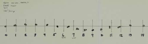

Let's cover one thing at a time and why being very methodical matters greatly. We'll start with a pic of a test target. You can clearly see group shape, size and poi changes.
For now, let's address poi. You can see a very clear sine wave on the target and a sweet spot very near both top and bottom of the sine wave, which is physically barrel swing. More later...
Mike, can you explain what the numbers at the bottom of your target are?

Brand is no different than lot changes. I'll get to it, if you care to listen. It goes without saying that we can count on you for your reply, so I was reluctant to offer an answer at all, for that reason. You're welcome to read along but keep in mind...this is MY method with pics and explanation of what the pics will show. IOW, why and how my method works. I'm glad you know how to tune a rifle, so there should be nothing for you to add to MY method. You can do that later or in a different thread. I think there are a number of people who will see the approach that I will describe and the logic behind it to be logical and beneficial. More so without arguments before I'm even started good. In the end, you do you.
